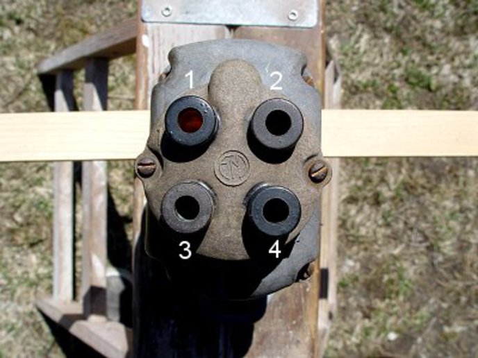

Hold your hand over the throat of the carburetor and see if there's good suction. Was the distributor removed for any reason? It may not be timed to No1 piston. Since it won't start you're missing either fuel or spark at the right time. Remove No1 sparkplug near the radiator and hold a thumb over the plug hole while a helper
slowly cranks the engine. Once you feel pressure drop a long plastic straw on top of the piston. Have the helper to keep cranking while you watch the straw rise. When the straw quits rising your No1 piston should be at TDC on the compression stroke. Remove the cap on the distributor and see where the rotor is pointing. It should be at your No1 plug tower. If you don't understand this
get a helper. Your plug wires need to be in this firing order on your distributor cap. Hal
