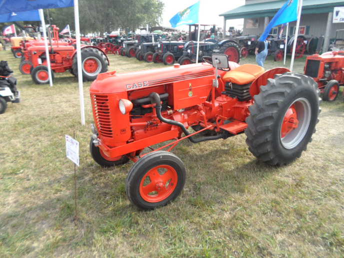

Case air-cooled A-125. Got one on a 77 Model pull type combine.
[Log in to Reply]  [No Email]

Years ago I heard that engine could be put in a VAC. True or not?

I doubt if the engine, air cooled would work for heavy drawbar work, plowing, discing. That's why they were put on combines and bailers.

True. Every once in a while one turns up. Think there was one at the Albert City Case show...if I could find it in my pics. Years ago I helped a friend put one in a 1530 Case Uni-loader.

connor9988
03-10-2018 18:18:01
Report to Moderator
 Re: Pics of 140 W Case bailer engine in reply to casecollectorsc, 03-08-2018 19:31:32
Here is the one that was at Albert City:
