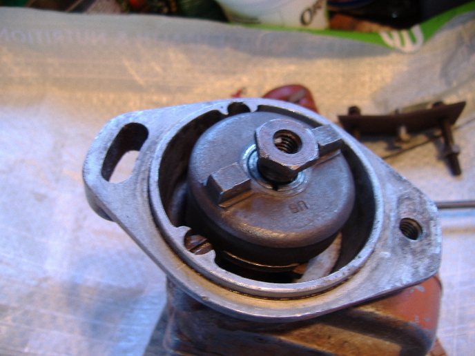

I have a Ford 2N. Got a ? on a mag. I bought a used mag on line its a FM J4B73 that is the # stamped in the metal housing and that is the # For the mag on this Ford. The one side of the housing and plastic cover has best I can tell AC orange paint sprayed on it. I know some AC takes a J mag so could this be off a AC?

Here is a pic of the typical FMJ4B used on AC. Does yours look the same? Same lag angle? Same direction of rotation (CW)? Same drive lugs? The retaining nut in the pic would normally be screwed down flush.

stu the mag comes off the adapter and when its off it looks like your photo.
With the mag off the adapter it might bolt onto a AC. While on the adapter it would be a hard sell LOL-----------.I was just curious if the mag on the Ford adapter may have come off an AC due

FM mags. will fit lots of different engines , but allis was a big user of those mags. so most end up with orange paint , ive actually use an IH mag. on my WD allis in a pinch , bottom line if it bolts on , spins the proper way it will most likly work even if it isnt the right mag.
The FM number for Allis Chalmers is FMJ4B3 or FMX4B3
An IH H4 and a Case JMA or model 41 will also work on an Allis.
