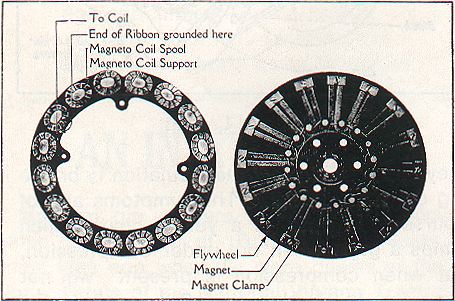

The generator is the unit which is the most "trouble free" of all components of the model F ignition (just as well as the tractor has to be split to get at it!!) the unit can be seen in the original manual illustaration.
There are two main problems, the first is man made...ie if a battery is used for starting and the lead is not removed from the pick up on the fly wheel there is a serious risk of the magneto becoming demagnetised....this has disasterous results to the current generation!. The second is simply wear,....whether by fair use or because the previous owners have neglected to change the oil often enough, or even let it run too low.
It is obvious that if electricity is to be produced by coils and magnets,.. as on the Fordson there is an optimum position for them to be held apart. This is 1/16" controlled by the end float of the crankshaft, which if wear has taken place can be more, in which case, too much gap will mean very hard starting due to poor current generation and too little will result in the components touching and cause desperate damage. However the latter is thankfully unusual as the heavy knocking caused by excessive end play usualy results in a major overhaul well before the damage occurs.

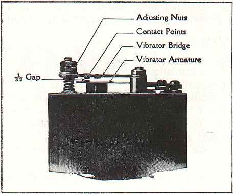

Inspect the contact points (see picture no:2) make sure they are clean, use a fine file to clean both faces of the contact points and be sure the spring is free to work and not corroded thus stiff to move. Set the gap by using the lock nuts, don't as previously mentioned bend or modify the flat strips upon which the points are mounted. Remember it will be necessary to hold down the vibrator armature to check the points gap.

A belt driven engine is usefull to check the voltage output from your fly wheel. The manual states that the F should dispense 14 volts at 1000 rpm. Down to 6 volts at 300 rpm. This lower voltage at cranking speed is why it is doubly important to have and keep points, plugs, commutator etc clean and adjusted correctly.
Talking of the fly wheel generator, if you are able to motor your machine via a pully get it up to speed about 1000 rpm, disconect the wire from the fly wheel pick up and connect it to a voltage meter. As stated it should read 14 volts. If it is low stop, remove the nipple from the pick up point on the casting, check that the spring is clean and not shorted out by dirt or pieces of swarf, or metalic particles. If metal is found then one must assume that the magnets are also contaminated and the machine should be split and corrective repair work under taken.If it is just gunge and dirt contaminating the nmagnets, try adding some deisel to the oil and flush the whole thing out...not forgetting to refill with clean fresh oil!! and under no circumstances should you attempt to run the machine with diesel in the oil.
