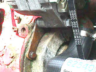

Once you have made the bracket, simply bolt it on where the old bracket was. The bottom of the alternator attaches to the bracket with a long 3/8" bolt and about a dozen spacer washers as shown in this photo. Make sure that the alternator pulley lines up with the crankshaft pulley. You can use the same tensioner bolt and tensioner bracket on top that the old generator used. Lastly, install the belt (preferably a new one) and tighten it with the alternator tensioner bolt. The mechanical portion of the alternator installation is now complete.

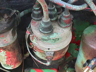

Close-up of unmodified distributorIn this photo, you can see a close-up of the original distributor cap and coil. Although not shown in this photo, I have already replaced the spark plugs with new ones prior to beginning the installation process. The old ones were badly corroded from moisture and non-use.

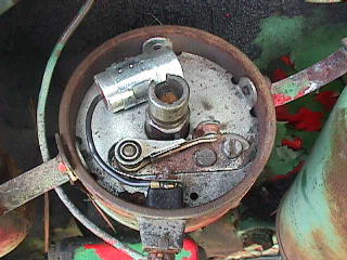

Distributor cap removedThe installation process begins by removing the distributor cap and dust plate to reveal the original points and condenser.

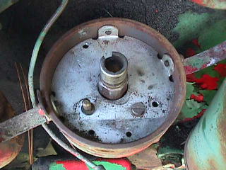

After removing the points and condensorIn order to install the electronic ignition kit, you have to remove the old points and condenser and the plastic insulator post that connect them. With a screwdriver, I removed the points and condenser in the usual way. I had to use the pliers to get the post out. The important thing to remember is that the original equipment has not been damaged and could be reinstalled if necessary.

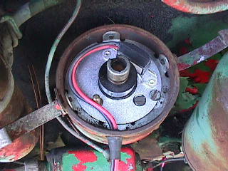

Installed the Electronic Module
Now I have installed the electronic ignition module "washer" using the same screw that used to hold the points in place. I also put the screw that held the condenser back in even though it really doesn't hold anything. Around the center shaft is a molded plastic magnetic inducer. This piece of plastic actually has four magnets in it that are precisely aligned to fit my distributor in this new configuration. The form fitting plastic makes it difficult to install incorrectly. Note that you have to feed the two wires through the hole where the insulator post used to be and install a rubber strain relief grommet.

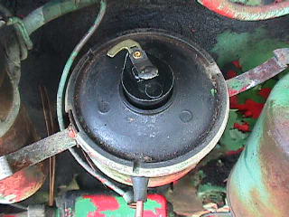

Start putting things back together Once the electronic ignition module was installed in the distributor, it was just a simple matter of reinstalling the new cap, rotor and dust plate. The hard part was over.

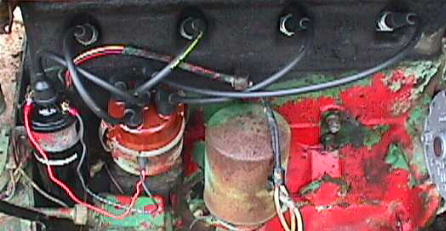

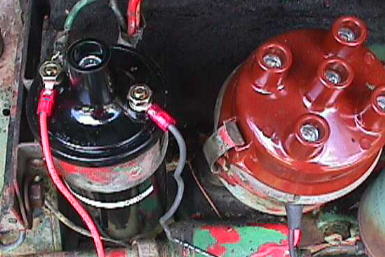

In this photo, I have replaced the old 6 volt coil with a brand new 12 volt coil that has an internal resistor. The connections are pretty simple. The red wire goes to the positive side of the coil. The black one goes to the negative side. The positive side of the coil also goes to the ignition switch. The old coil was for a positive ground and had the negative side going to the ignition switch, but since everything is negative ground now, we have to do it this way.

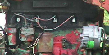

Now on to installing the new wiresLastly, I have installed a new set of spark plug wires. When I cranked the tractor for the first time after installation, it started right up. It spit a bunch of rust out of the exhaust pipe which I assume was from sitting for so long.

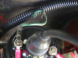

Ignition Wire One thing about the Genesee wiring harness is that there is room to slide the old ignition wire in there. There is a slit that runs the length of the harness. This photo shows how I slipped the old coil wire in with the alternator wires. This is totally unnecessary, but it gives the tractor wiring a cleaner look.
