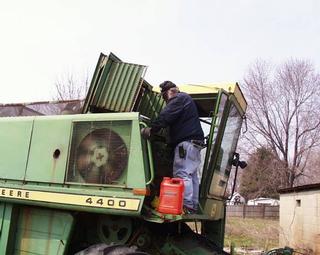

John and I returned to the lot on Saturday, March 31 around 10 A.M. We spent over an hour prepping the machine. I filled the hydraulic reservoir and pumped up the rear tires. John changed the oil and replaced the filter. That old oil filter was packed with oily sludge! John also added 10 gallons of gas. There was still about 15 gallons of year old gas in the tank. John checked the final drives and they were still full of dirty 90 weight oil. We mounted a battery and I started cranking the engine. It had been almost a year since I had last run it, so I was not real hopeful we would get it started. The engine started sputtering immediately. On the second try I held the starter for a long time while John sprayed starting fluid and work the choke. This time the engine came to life on about 4 cylinders. After a minute or so, she was firing on all six. After 15 minutes of running, John adjusted the idle and high speed mixture screws.
At this point I returned home to pick up Corey. John was going to work the gears and determine if the combine was road ready. Saturday was a beautiful day in Indy with the temperature at 50 degrees. Rain was in the forecast for Sunday, so we started laying out plans to at least move the combine 5 or 10 miles. When I returned with Corey, the combine was not running and John was under the deck looking at another hydraulic leak. Apparently that leak on the side of the combine was for real but we couldn’t find the source. I had John pull the seat out and raise the lid. We fired the engine back up and started leak hunting. John worked the steering wheel, but the steering lines were not leaking. He then moved the variable speed lever and hydraulic fluid started gushing out of two lines that hook into the variable pulley assembly. As long as we didn’t bump the handle, we would not have to worry about losing hydraulic fluid.

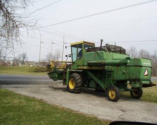

After we returned to the combine, we discussed the route and decided to go for it. Being a Saturday, traffic would not be quite as heavy as during a weekday. However we had a good 10 miles of driving in Indianapolis type of traffic before we would be out in the country. John drove the combine up to the street. Corey and I would follow in my pickup with emergency flashers operating, and a bed full of tools, hydraulic oil and water. I also had the digital camera ready to take pictures of our trip. It took about 10 minutes for John to get the combine in 3rd. gear. We needed that gear or the trip would have been way too slow. He finally got it in gear and we were off. In third gear with full throttle, we were moving at 7 miles per hour.
We are proceeding south on a very busy Indianapolis street. The housing on the right was farm fields 5 years ago!
Traffic for the first 10 miles was absolutely horrible. We pulled over 3 different times to let traffic pass. We had 50 vehicles pile up behind us on those 3 occasions. As we pulled off the road, vehicles would pass with blaring horns. Fortunately John could not hear the horns due to the noisy combine. But Corey and I could hear it! Each time we pulled over, I jumped out of the pickup and did a walk around the combine. The only leak was some water that was dripping out of one of the final drives. Apparently rainwater had gotten into the casing through the years.
As we approached Avon, John’s daughter joined the convoy in her car. After we crossed Indiana 267, we were finally in the country with little traffic to contend with. The combine ran very well with good steering. John had to maneuver around a lot of mailboxes on the route. The engine was running very smooth but the drive belts were slipping. We pulled over and tried to tighten the belts. I think we were partially successful because the belts made less noise when we climbed the next couple of small hills.
At 7 miles per hour we had a lot of time to sightsee and reflect. Corey saw some horses and a herd of sheep. I was looking at the homes in the new neighborhoods that had claimed so much prime farmland over the last 5 years. I was also saddened about not finishing this project as planned. Sometimes events in life don’t happen as planned. At about 12 miles, and 2 hours of driving, I broke away from the convoy and returned home. Corey was getting antsy and I wanted to drive back home and simply forget about the project. John called at 6:00 P.M. He successfully drove the combine 25 miles in total to his Groveland home. He had one incident during the last part of the trip. He bumped the electric switch that runs the fuel pump. The combine dropped dead in the middle of U.S. 36 with traffic piled up behind the combine. Fortunately he was able to start it right up and move on. I am happy for John because he should be able to get the combine field ready for less than $1,000. He has 220 acres of tillable land so the combine will get a good workout each fall.
